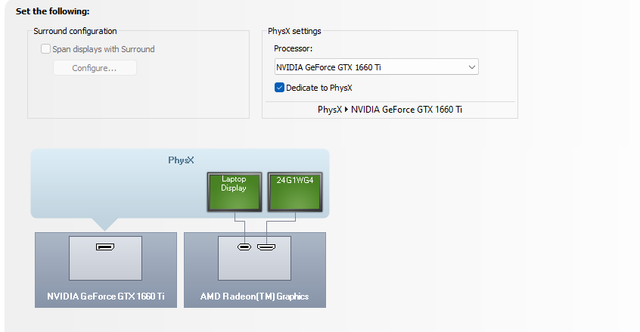

I feel like the laptop is underperforming. It's like it doesn't know if it should use the CPU or the GPU graphics. I have selected specific games to use the GPU in nvidia settings but I still get FPS drops on games such as Rocket League.
Also this confuses me, see image below: So the laptop monitor and my 2nd monitor uses the CPU instead of the GPU for physx. In the image it appears as if there is a DP port for the 1660ti , but the laptop only has 1 HDMI port?
[Image: Screenshot-2024-04-01-gpu.png]

These specs should be getting you around 200-250FPS in Rocket League when you have only a single monitor enabled. Just for the heck of it, try running on just the laptop display or just the monitor and see if you can get this range.
The image is fine. Internal laptop display is still connected internally to a port. The type of port doesn't matter as it's internal only and the graphic may or may not actually represent connection type.
As far as troubleshooting goes to resolve this, I'd set the physx option to auto-select and don't check the box for dedicate this gpu to physx. It's possible some combination of the game and your geforce experience/nvidia control panel settings conflict and since you have integrated radeon gpu, you could get weird performance issues due to the Nvidia GPU being sometimes used for PhysX only and not normal game play.
